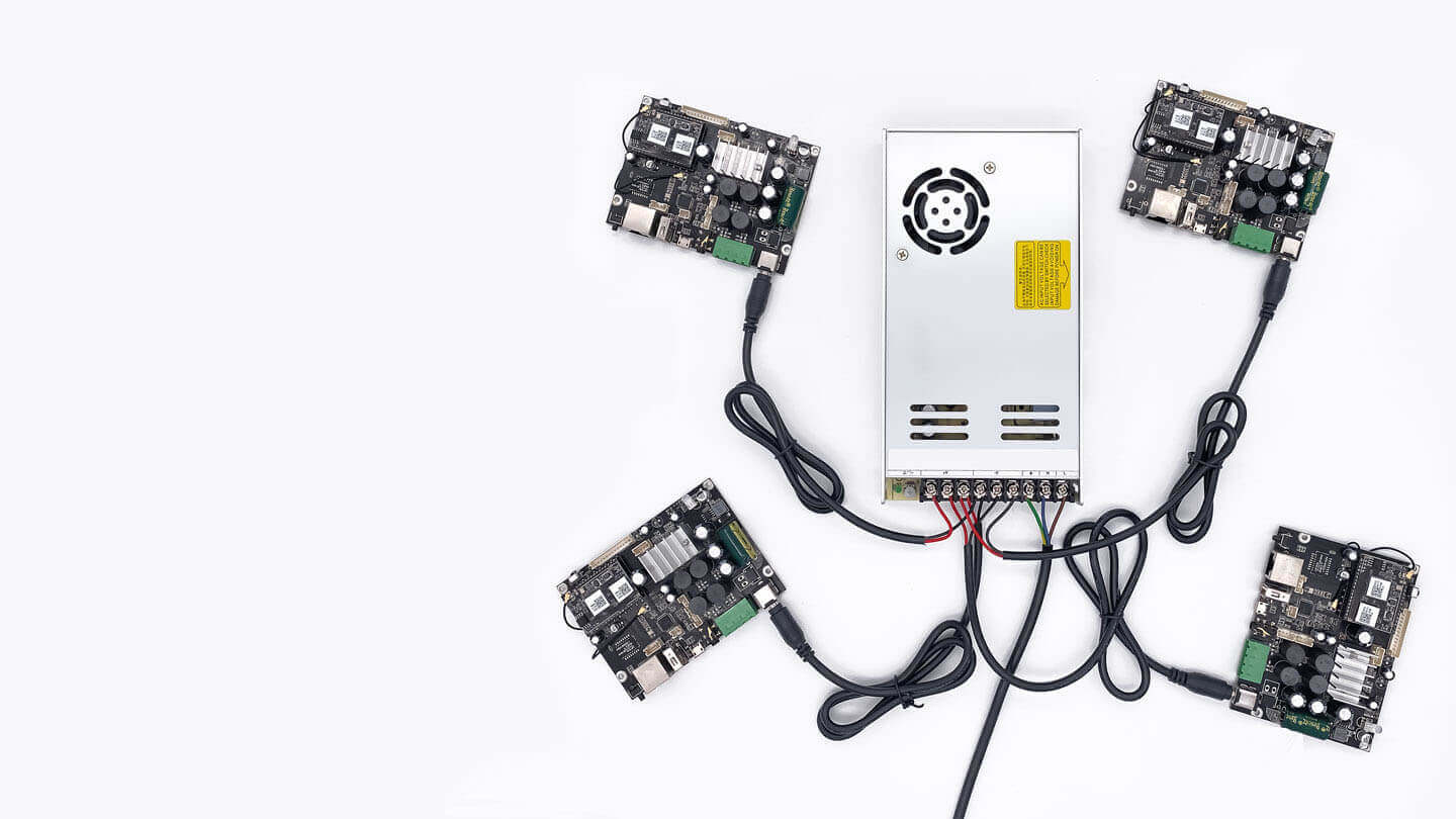

Unlike normal power supply that can only connect to one device, SPS-350 power supply can provide power to multiple devices at the same time.
350W switching power supply
350W Switching Power Supply
350W power supply
High Watt power
SPS-350 have 350W power supply and can provide power up to 4 Up2stream AMP 2.0 devices. You can easily calculate how many devices you can connect by dividing the Watts the connected device required.

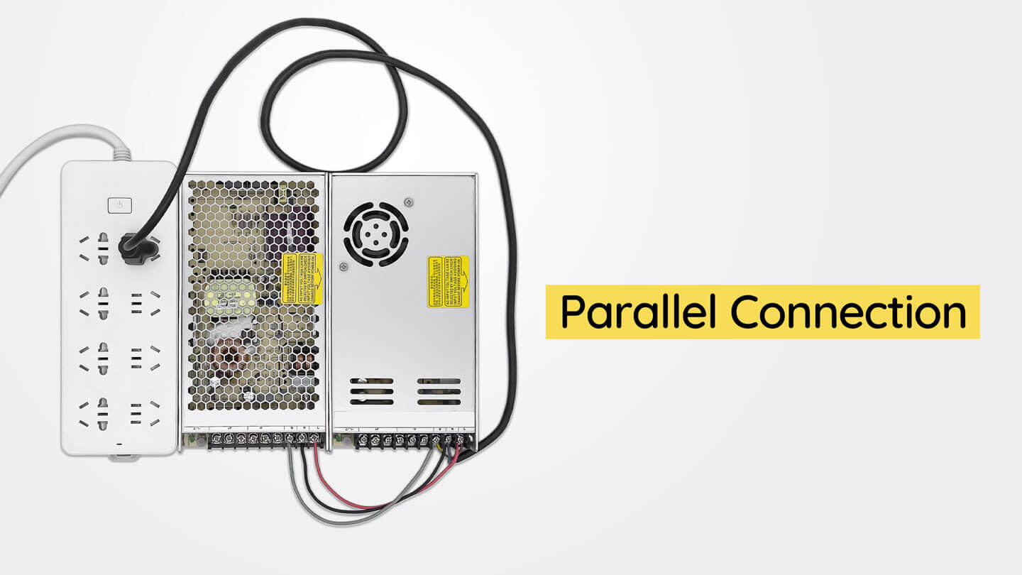

Connect Multiple Power Supply in Parallel
You can connect multiple power supply in parallel for easy installation in the power box and to host more devices at the same time.
